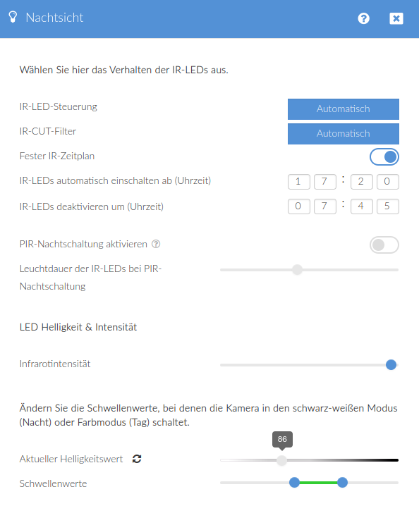

What about the slider for the brightness/intensity of the IR-LED? 100% ?

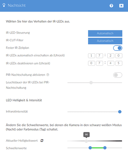

And another idea belongs to the schedule for IR-LED. Are there any times activated?
And what about the threshold for switching between day & night mode. You will get dark pictures when the threshold for returning to day mode is too close to the threshold for entering night mode (low hysteresis).

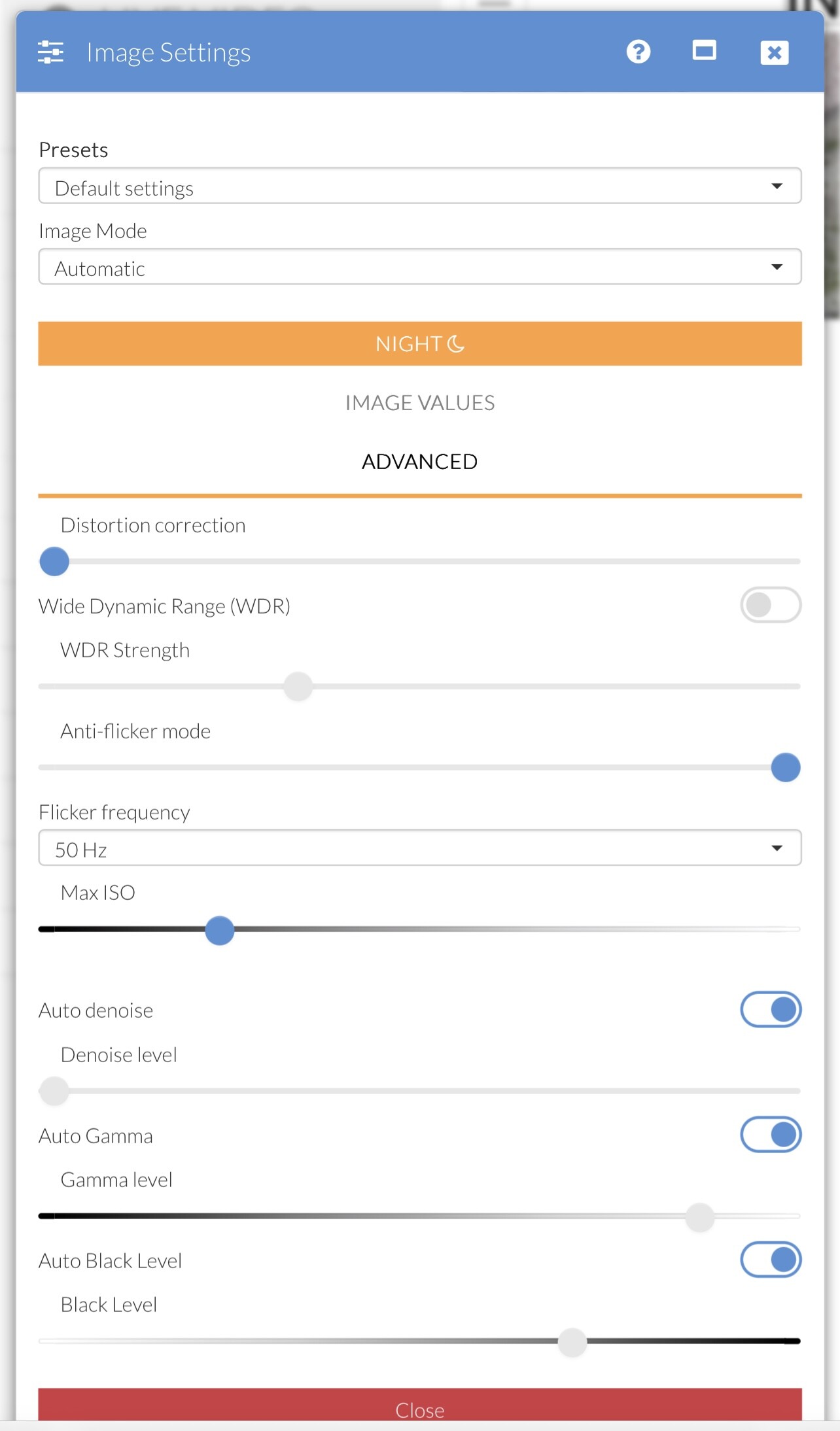

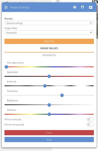

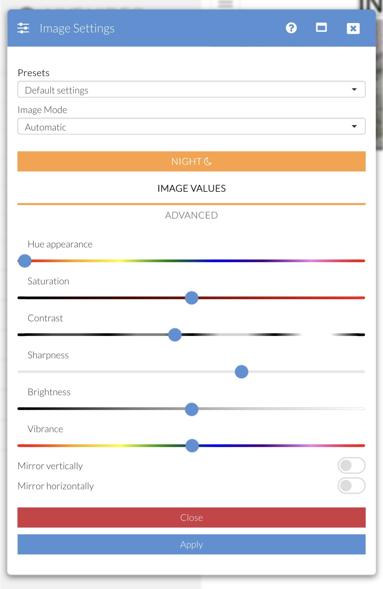

I left it all default. WDR is not enabled. I attached the config for reference.
The image setting:
The advanced image setting:

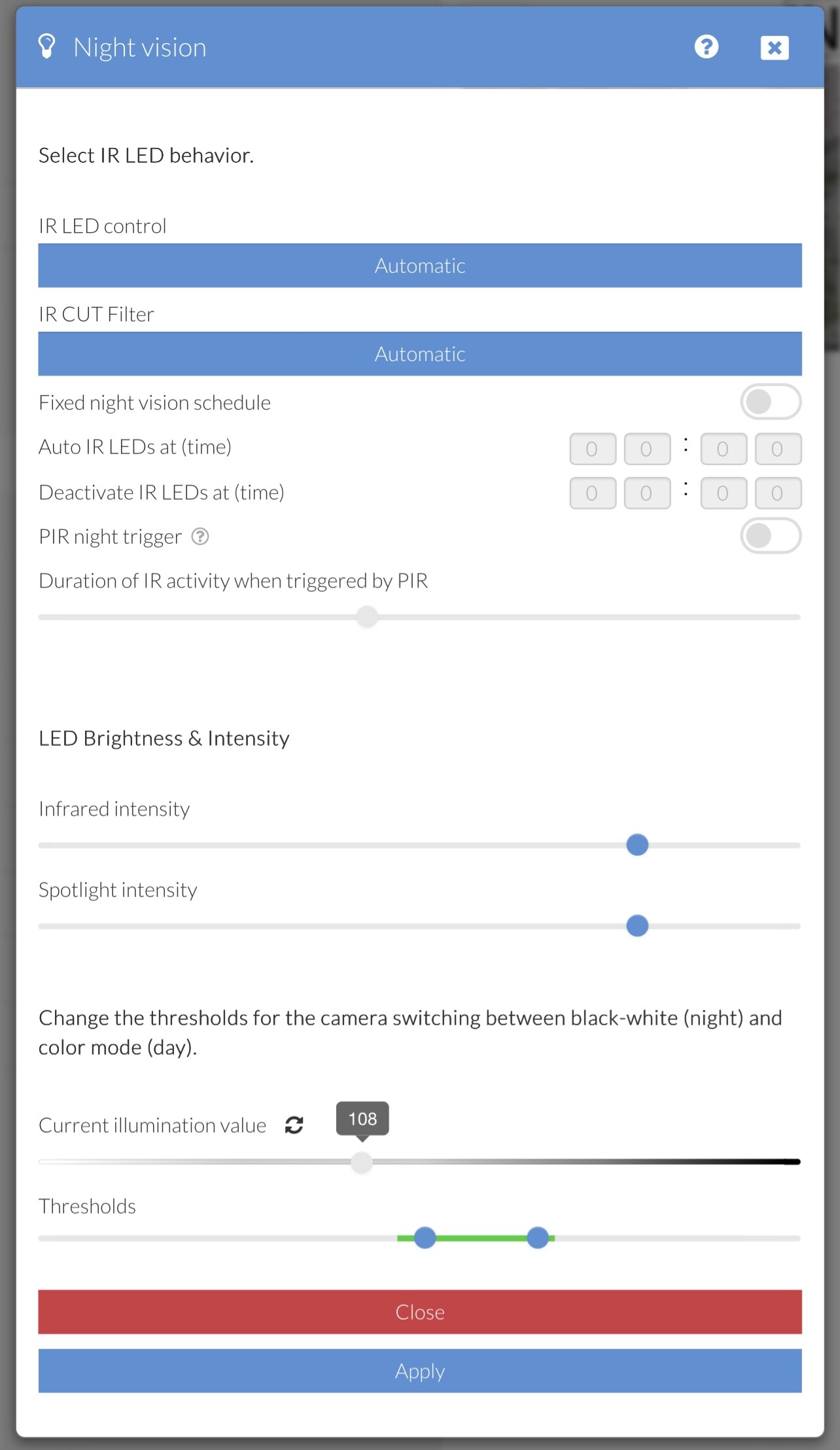

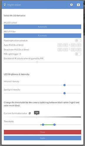

Did you try to set the spotlight intensity to zero?
I have not. I just set it to 0.
But from my understanding the spotlight intensity refers to the brightness of the white led light (which I don’t use.)
